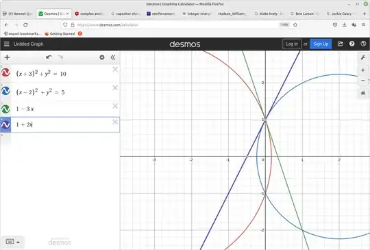

I had it draw your diagram. The angle at which your two circles meet at $i$ or $(0,1)$ is the angle between the tangent lines $y = 1-3x$ and $y = 1 + 2x.$ Or between vectors $(-1,3)$ and $(1,2)$
Meanwhile, the derivative of Moebius transformation $\frac{az+b}{cz+d}$ is simply $\frac{ad-bc}{(cz+d)^2}.$ So, other than the point it sends to infinity, it preserves angles.
