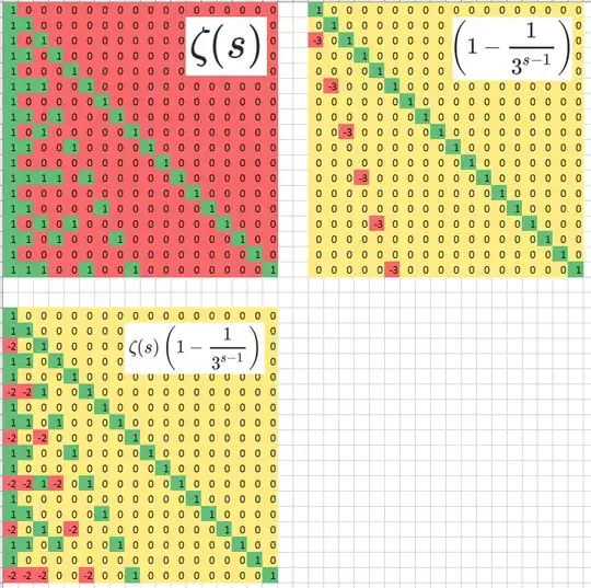

Here is how I like to think of this series: Visual matrix multiplication proof
The third matrix is the result of the matrix multiplication of the upper two matrices.
Then form the limit at $s \rightarrow 1$ with the Dirichlet generating function:
$$\lim_{s\to 1} \, \zeta (s)\left(1-\frac{1}{3^{s-1}}\right) =\log (3)$$
Mats Granvik
  • 7,614
