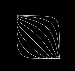

Here is a plot of the $J$-distribution for several distinct values of $t:$

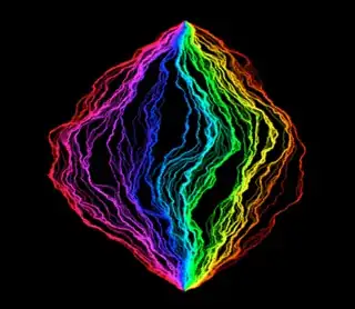

You can imagine with addition of the $\dot J$-noise the curves will look something like this (rotated accordingly):
How would you write down the noisy solution, that is, the stochastic version of $J_t(x)?$
