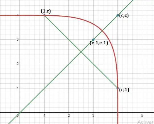

►It seems to me that in fact for $n=2$ there are infinitely many solutions but they all are "trivial" (in the sens of as see at comment above). In fact the general solution of the equation $a^2+b^2=c^2+d^2$ is given by the identity with four parameters $$(rX+sY)^2+(rY-sX)^2=(rX-sY)^2+(rY+sX)^2\hspace 2cm(*)$$ so for each choice of $r,s$ coprimes we have the restriction $$rY+sX=1\hspace 2cm(**)$$ which have an infinite number of integer solutions. However the standard form of these last solutions leads for each choice of $r,s$ and each solution of $(**)$ to a solution of $(*)$ which is of the form $(a,b,c)=(1,t,t)$ as we can verify.
►►The following, I believe, is a plausible first step to a proof of the impossibility for $n$ even i leave to the O.P. to finish if he want to.
If $n$ is even then the curve $x^n+y^n=k$ where $k=c^n+1$ is closed and $(\pm x)^n+(\pm y)^n=k$ so it is enough to study the curve in the first quadrant, By convexity, the arc of the curve defined by the "trivial" solutions $(c,1)$ and $(1,c)$ is inside the triangle of vertex $(c,1),(1,c),(c,c)$ and we can deduce that this arc does not have any other integer point that the two trivial solutions.
