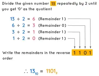

And, copying the examples generated by the link, the detailed answer is:
  • Yes, the standard "base p" notation is the p-adic notation for small integers of $\mathbb{N}$
  • 0 = (0,0,0,...)2 = $0_2 ~~=? \infty$
  • 1 = (1,0,0,...)2 = $1_2$
  • 2 = (0,1,0,0,...)2 = $01_2$
  • 3 = (1,1,0,0,...)2 = $11_2$
  • 13 = (1,1,0,1,0,0,...)2 = $1101_2$
  • 12345 = (1,1,0,0,0,0,0,0,1,1,1,0,0,1,0,0,...)2 = $11000000111001_2$
  • 123456789 = $\dots 10111100110100010101_2$
  • 1234567891234567 = $\dots 10111010111100000111_2$
You can check the case of 13 by this illustration
PS: inductive reasoning is very important for non-mathematicians, to confirm that the interpretation of mathematician notation is correct.
