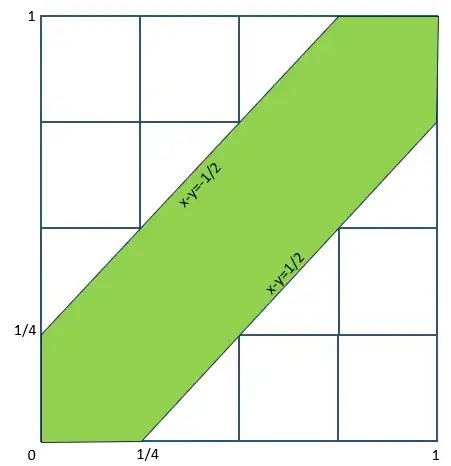

But I find it so difficult to understand, because conventions are not settled that I propose you instead a very easy graphical solution based on the following figure :
where a point with coordinates $(X,Y)$ means persons $A,B$ arrive at times $X,Y$ resp. This point is uniformly distributed in $[0,1] \times [0,1]$.
The green elongated hexagon corresponds to dates of arrival complying with the condition.
Its area is the looked-for probability. It is obtained by subtracting to $1$ the complementary probability, i.e., the areas of the two white triangles :
$$1- 2 \tfrac12 (\tfrac34)^2=1-\tfrac{9}{16}=\tfrac{7}{16}$$
