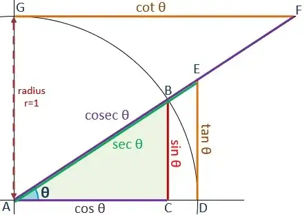

SO I know that a tangent line is a line that touches a curve at one point, and a secant line is a line that touches a curve at TWO points, but what do tangent and secant lines have to do with tangent (tan(x)) and secant (sec(x)) functions?

The names are indeed what they sound like. This image says it all:
(found at https://www.mathematicalway.com/mathematics/trigonometry/tangent/).
FYI, "tangent" and "secant" come from Latin participles mean "touching" and "cutting", so the tangent line $DE$ glances off the circle whereas the secant line $AE$ cuts across it.
