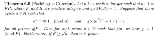

I have a problem in the proof of the Pocklington criteria. The theorem itself is enter image description here

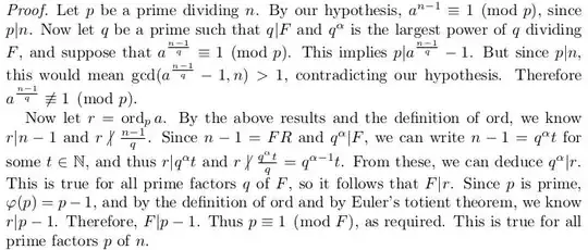

Now I have this proof (my question concerns a point in the last three lines):
My question is: So we choose $p$ to be a prime divisor $n$. So $\varphi(p) = p-1$. I know that $a^{n-1}\equiv 1\pmod p$. Now the proof says that by euler's totient theorem we can deduce $r\mid p-1$. But I do not understand why. Shouldn't we assume that $p$ and $a$ coprime to deduce this?
