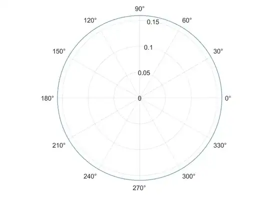

which fulfills the usual normalization condition. A plot of $P_{uniform,2D}\left(\varphi\right) = \frac{1}{2\pi}$ looks circular:
Uniform, two-dimensional PDF

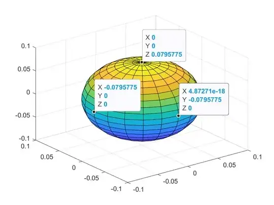

Using the same (geometry-based) derivation path, I get the correct uniform PDF for the sphere:
$P_{uniform,3D}\left(\vartheta,\varphi\right) = \frac{1}{4\pi}$
A plot of $P_{uniform,3D}\left(\varphi\right) = \frac{1}{4\pi}$ looks spherical:
Uniform, three-dimensional PDF

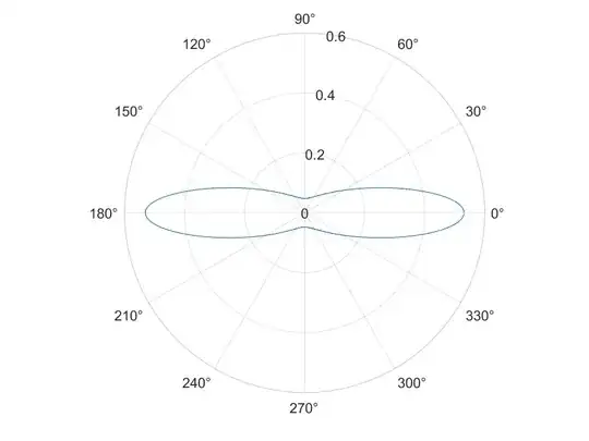

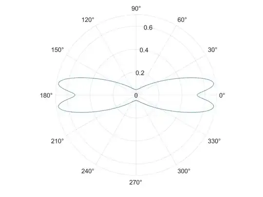

Now, the problem is that, if I do:
$\frac{dA_{ellipse}}{A_{ellipse}} = \frac{\left(\frac{1}{2} \cdot r_{ellipse} \cdot dS_{ellipse}\right)}{\pi b} = P_{nonuniform,2D}\left(\varphi\right)d\varphi$
or also with $dS_{ellipse} = r_{ellipse} \cdot d\varphi$ as suggested in the comments below, instead of $dS_{ellipse}$ as in the original expression further above; I either get 1) a PDF that neither exhibits an elliptical shape, nor satisfies the normalization condition (if I use the original $dS_{ellipse}$ expression), here the respective plot:
Nonuniform, two-dimensional PDF 1, b = 0.3
or 2) a PDF that does satisfy the normalization condition, but does not exhibit the shape of an ellipse (if I use the abovementioned $dS_{circle}$ variant), here the respective plot:
Nonuniform, two-dimensional PDF 2, b = 0.3

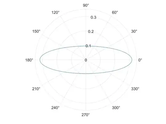

I am insisting with this need for an ellipse-shaped PDF, because I have found (in the literature) a more expedite (also geometry-based) path for deriving the nonuniform, two-dimensional PDF in question, namely by dividing the elliptical radius, $r_{ellipse}$, defined above, by the integral over $\varphi$ of the elliptical radius; so:
$P_{nonuniform,2D}\left(\varphi\right) = \frac{r_{ellipse}}{\int_{0}^{2\pi}r_{ellipse}}$
The latter PDF expression exhibits the shape of an ellipse in a polar plot:
Nonuniform, two-dimensional PDF 3, b = 0.3
and satisfies the normalization condition. However, I don't know how theoretically sound this latter derivation path is, which is why I was trying to reach equivalent results via the first, seemingly theoretically sounder derivation path further above.

  • OK. Meanwhile, I understood why the PDF $P_{nonuniform,2D}\left(\varphi\right) = \frac{b}{2\pi \left[ \left(b\cos\left(\varphi\right)\right)^2 + \sin\left(\varphi\right)^2 \right]}$ does not exhibit the ellipse shape in a polar plot. That's because we square the elliptical radius $r_{ellipse}$ to calculate the infinitesimal area element. If I use a constant radius of $1$ times the elliptical radius, I get the ellipse shape. However, the resulting expression does not satisfy the normalization condition. The appropriate normalization factor would be the integral over $\varphi$ of $r_{ellipse}$. – Euclides Jul 18 '23 at 11:19
  • I think this PDF with infinitesimal area element $dA = \frac{1}{2}r_{ellipse}r_{circle}d\varphi$ might be the correct one, since for the infinitesimal area element oriented at a given $\varphi$, its height (elliptical radius) does change, but the base remains constant, which, to me, indicates we should be using the infinitesimal arc length of the unit circle, including the unit radius. I could be wrong though. If I am right, then the correct PDF should be $P_{nonuniform,2D}\left(\varphi\right) = \frac{r_{ellipse}}{\int_{0}^{2\pi} r_{ellipse}}$............. – Euclides Jul 18 '23 at 11:32

  • now, the next question is that, after all these rigorous derivations and implementations, a plot of the PDF still has the shape of the third plot (i.e., of the first plot for the ellipse PDF derivation part of the question) in my original question/ post. So, I am unsure if the PDF defined as $p(\varphi) = \frac{dS}{S}$ is actually conceptually rigorous. Shouldn't the PDF exhibit the shape of an ellipse? Since we are using ellipse-related quantities for its definition? Or only quantities following that PDF will exhibit the shape of an ellipse of given $b$? How is that? – Euclides Dec 02 '23 at 14:24
