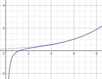

But for other functions like $e^{n \cdot x}$, it comes out weirdly like this: $$ \begin{align*} \operatorname{^{\mathcal{L}}D}\limits_{x}^{\alpha}\left[ e^{n \cdot x} \right] &= e^{n \cdot x} \cdot n ^{\alpha} \cdot \left( \frac{\alpha \cdot \Gamma\left( -\alpha,\, n \cdot x \right)}{\Gamma\left (-\alpha + 1 \right)} + 1 \right) - \sum\limits_{k = 1}^{\operatorname{round}\left( \alpha \right)}\left(\frac{1}{\Gamma\left( k - \alpha + 1 \right)} n^{\alpha} \cdot x^{k - \alpha - 1} \right) \end{align*} $$
A plot of this for $\alpha = 2 \wedge n = 0.3$ ($\color{Purple}{\operatorname{^{\mathcal{L}}D}\limits_{x}^{\alpha}\left[ e^{n \cdot x} \right]} \wedge \color{Blue}{\frac{\operatorname{d}^{2}}{\operatorname{d}x^{2}} e^{n \cdot x}}$) - desmos:
or desoms graph to exp
But ignoring the sum term gives a much better representation of reality:
desmos graph to exp without sum term
Why? What is wrong here?
