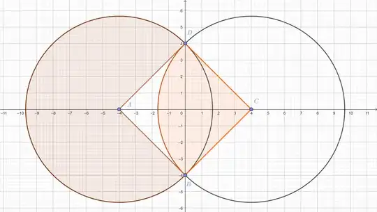

Write $w=z-4i$, which amounts to a translation, so we intersect the the disk $\mathcal D$ centered in $-4$ with radius $4\sqrt 2$ with the exterior of the disk $\mathcal D'$ centered in $4$ with same radius: $$ \begin{align*} |w+4| &\leq 4\sqrt 2\ ,\\ |w-4| &\geq 4\sqrt 2\ . \end{align*} $$ Picture proof:
area computation for the intersection of a disk with the exterior of the other disk
Let $A,B,C,D$ be the points on the axes at distance $4$ from the origin, as shown in the picture. The square $ABCD$ has sides equal to $4\sqrt 2$. We need the area of the disk $\mathcal D$ centered in $A$ and radius $AB=AD=4\sqrt 2$ after removing the $BD$-reflected disk $\mathcal D'$ from it. The needed area is the brown region, $\frac 34\cdot \pi AB^2$, plus the square area $AB^2$, minus the orange area $\frac 14\cdot \pi CD^2$, this is: $$ \left(\frac 34-\frac 14\right)\pi(4\sqrt 2)^2+(4\sqrt 2)^2 = \frac 12\cdot\pi\cdot 16\cdot 2+ 16\cdot 2 = 16(\pi+2) \ . $$
