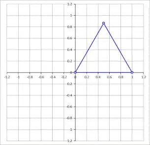

The image below depicts the situation. An unit equilateral triangle has two of its vertices sliding along the $x$ and $y$ axes, as shown. What is the curve traced by the third vertex? If it is an ellipse, what is its equation?

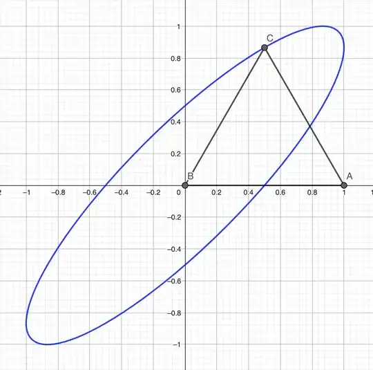

I sketched all of the above up in GeoGebra, and obtained the following image (note that the naming of the vertices is different, as GeoGebra has its own conventions):
The complete GeoGebra demonstration can be found at https://www.geogebra.org/calculator/jtehwfh7 .
The moral of the story is that the curve can be parameterized by the function $$ v(t) = \left( \frac{1}{2} \sin(t) + \frac{\sqrt{3}}{2}\cos(t), \frac{1}{2} \cos(t) + \frac{\sqrt{3}}{2} \sin(t) \right), $$ where $t$ runs over the real numbers (though $v$ is $2\pi$-periodic, so it is only necessary to parameterize over, say, $[0,2\pi]$).
I claim that this is a parameterization of an ellipse. However, instead of reinventing the wheel, I will refer the interested reader to https://math.stackexchange.com/a/2647450/ , where a generalized parameterization of an ellipse is derived. One can work backward from the linked answer to the formula in the question.
