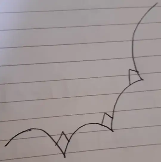

My guess is that, yes, they exist. A small section of one might look like this:
I imagine them to live on the surface of some warped shape, perhaps in a high number of dimensions.

    For any $n>4$ we can get orthangles (= polygons with all right angles) with $n$ sides in the hyperbolic plane: take a very small regular $n$-gon and gradually expand it until the angle defect gets bad/good enough. – Noah Schweber Jul 07 '23 at 13:20

    @Shaun: "All you have to do" is convince yourself that you can make an isosceles triangle with base angles of $45^\circ$ and a vertex angle of $360^\circ/n$. (Then, $n$ of this would fit around the vertex point to make the desired polygon.) But, the angle-sum of such a triangle is $90^\circ (n+4)/n$; for $n>4$, this sum is less than $180^\circ$, so that the angles correspond to a valid hyperbolic triangle. (You could, for instance, use the Hyperbolic Law of Cosines to calculate the corresponding side-lengths.) – Blue Jul 07 '23 at 14:44

For any $n>4$ we can get orthangles (= polygons with all right angles) with $n$ sides in the hyperbolic plane: take a very small regular $n$-gon and gradually expand it until the angle defect gets bad/good enough. (I don't know a source about this specifically, but it's a consequence of the general angle defect behavior of the hyperbolic plane.)
More precisely, for $r>0$ let $C_r$ be a circle in the hyperbolic plane with radius $r$ and let $P_r$ be an equally-spaced set of $n$ points on $C_r$. Let $\alpha_r$ be the interior angle at any vertex in (the polygon formed by) $P_r$. By the angle defect formula for the hyperbolic plane, we have $\lim_{r\rightarrow\infty}\alpha_r=0$ and $\lim_{r\rightarrow 0^+}\alpha_r={(n-2)\pi\over n}$, and moreover $\alpha_r$ is continuous as a function of $r$. By the intermediate value theorem, some $r_0$ has $\alpha_{r_0}={\pi\over 2}$ (note that we need ${(n-2)\pi\over n}>{\pi\over 2}$ here, which is where the assumption $n>4$ comes in).
