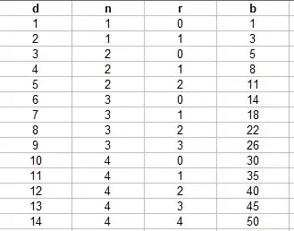

After $d$ days, where $$d=1+2+\dots+n+r=\frac{n(n+1)}2+r,\quad0\le r\le n,$$ the number of borrowed books is $$b_d=1^2+2^2+\dots+n^2+(n+1)r=\frac{n(n+1)(2n+1)}6+(n+1)r.$$
Given $d,$ the "rest" $r$ can be deduced from $n,$ which itself can be found as the index of the largest triangular number $\le d$: $$n=\left\lfloor\frac{\sqrt{8d+1}-1}2\right\rfloor.$$
As a check, here is a screenshot of the first values given by these formulas, on a spreadsheet of OpenOffice:
Note moreover that for large numbers $d$, these direct formulas are less calculation-consuming than iterative or recursive ones.

  • Thank you all for the valuable insight. With this in mind - I have been looking and considering the calculation of 'r' / 'rest' . Suppose my program starts and the first input days' query I receive is d = 11. Using the formula for calculating n from d --> I can get that n= 4 (thank you @AnneBauval , already done so) but then I look at the value of r , r = 1 so it is not the first row for which n = 4 , however I do not yet know this. For a randomly given d , am I correct in stating that the program will need to perform a few previous d's calculations to find the correct value of r. – yarong76 Jun 22 '23 at 19:26
  • This will the case when the value of n=4 drops down to n=3 (for d = 9, where immediately I can then say that for d=9-->r=3). Since I performed 2 additional calculations, I then know that for d=11 (original problem), r = 1). Performing the additional calculations is for sure a benefit , as the program can cache previously requested d's (so if user requests result of d = 10, I will have performed it already). Again, I now understand 0 <= r <= n , we can not know directly the value of r directly from d - unless I am wrong ? :) – yarong76 Jun 22 '23 at 19:30
  • No "additional calculations" are needed, the calculation of $n, r,b$ from $d$ is direct (this is the main advantage of this answer over @Piita's):$$n:=\left\lfloor\frac{\sqrt{8d+1}-1}2\right\rfloor,\quad r:=d-\frac{n(n+1)}2,$$$$b:=\frac{n(n+1)(2n+1)}6+(n+1)r,$$ nothing more. You can even squeeze the calculation of $r:$ $$b=(n+1)\left(d-\frac{n(n+2)}6\right).$$ – Anne Bauval Jun 22 '23 at 21:46
  • I don't know if "squeeze" is the right word. I meant you can bypass that step. – Anne Bauval Jun 22 '23 at 21:57
