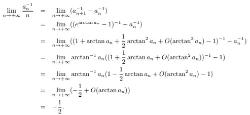

Given $a_1 = -1$ and $a_{n+1} = e^{\arctan(a_n)}-1$ find $c$ such that $a_n \sim \frac cn$, $n\to+\infty$
I proved that this series converges to $0$, but I was unable to do the question in the title. In my book the following solution is given. Using Stolz–Cesàro theorem, we get:
From which we conclude that $c = -2$. I see that in this solution we used Taylor expansions of $e^{\arctan(a_n)}$ and $(1 + \frac 12 \arctan(a_n) + O(\arctan^2(a_n))^{-1}$. I just don't get it where did $a_n^{-1}$ go and I am not sure if I am right in my reasoning why $(1 + \frac 12 \arctan(a_n) + O(\arctan^2(a_n))^{-1} = 1 - \frac 12 \arctan(a_n) + O(\arctan^2(a_n))$.

It seems they are using that for $a_n\to 0$
$$\arctan a_n=a_n-\frac13 a_n^3+O\left(a^5_n\right) $$
and then
$$a_n^{-1} =\arctan^{-1} a_n+O\left(\arctan a_n\right)\tag 1$$
therefore
$$\left(1+\arctan a_n +\frac12 \arctan^2 a_n +O\left(\arctan^3 a_n\right)-1\right)^{-1}-a_n^{-1}$$
$$\left(\arctan a_n +\frac12 \arctan^2 a_n +O\left(\arctan^3 a_n\right)\right)^{-1}-\arctan^{-1} a_n+O\left(\arctan a_n\right)$$
$$\arctan^{-1} a_n \left(\left(1+\frac12 \arctan a_n+O\left(\arctan^2 a_n\right)\right)^{-1}-1+O\left(\arctan^2 a_n\right)\right)$$
$$\arctan^{-1} a_n\left( \left(1-\frac12 \arctan a_n+O\left(\arctan^2 a_n\right)\right)-1+O\left(\arctan^2 a_n\right)\right)$$
$$\arctan^{-1} a_n\left(-\frac12 \arctan a_n+O\left(\arctan^2 a_n\right)\right)$$
$$-\frac12 +O\left(\arctan a_n\right) \to -\frac12$$
As an alternative we could use that
$$\frac1{e^{\arctan a_n}-1}- \frac1{a_n}=\frac1{e^{\arctan a_n}-1}- \frac1{\arctan a_n}+O\left(\arctan a_n\right)$$
and by $x=\arctan a_n \to 0$ we reduce to
$$\frac1{e^x-1}- \frac1{x} =-\frac{e^x-1-x}{x(e^x-1)}=-\frac x{e^x-1}\frac{e^x-1-x}{x^2} \to -\frac12$$
Justification of $(1)$
We have that
$$\frac{\frac{1}{a_n}-\frac{1}{\arctan a_n}}{\arctan a_n}=\frac{\arctan a_n-a_n}{a_n\;\arctan^2 a_n}=\frac{-\frac13 a_n^3+O(a_n^5)}{a_n^3+O(a_n^5)}\to -\frac13$$
therefore, by definition
$$a_n^{-1} =\arctan^{-1} a_n+O\left(\arctan a_n\right)$$
user
  • 162,563
  • How did you get $a_n^{-1} =\arctan^{-1} a_n+O\left(\arctan a_n\right)$ (where did that $O\left(\arctan a_n\right)$ come from)? Also, did I make a mistake in proving my second question? – Ranko Jun 21 '23 at 17:55
  • You are right all the squared part is $O(\arctan^2 a_n)$. – user Jun 21 '23 at 18:00
  • And what about my first question in comment above? And why are those first two equalities equivalente? I get the $\Rightarrow$ part, it follows from the fact that $\arctan(x) \geq x$ when $x \leq 0$, and all terms in my sequence are in interval $[-1, 0]$, but what about the other part? – Ranko Jun 21 '23 at 18:21
  • I mean I get the $\Leftarrow$ part – Ranko Jun 21 '23 at 18:30
  • Sorry I didn’t see the first question, I add something on that to explain the equivalence – user Jun 21 '23 at 18:40
  • @Ranko I've added the justification for $a_n^{-1} =\arctan^{-1} a_n+O\left(\arctan a_n\right)$. Let me know if all is clear now. – user Jun 21 '23 at 19:14
  • Shouldn't the limit in justification be equal to $-\frac 13$? Also, can you explain me how you derived equivalnce above $(1)$? – Ranko Jun 21 '23 at 20:15
    @Ranko Yes of course, it is $-\frac13$ indeed, anyway this doesn't change the result. For the other equivalence we can proceed again by the definition and note that $$\frac{a_n -\arctan a_n}{\arctan^2 a_n} \to 0$$ but at the end it is not necessary to prove (1). – user Jun 21 '23 at 20:21
  • @Ranko Now it should be more consistent and clear! – user Jun 21 '23 at 20:25
    I was confused about the equivalence part, but this edited solution is perfectly clear to me. Thank you! – Ranko Jun 21 '23 at 20:31
