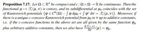

EDIT: After some discussion with Nate River and another acquaintance of our's, we have found a result which is relevant to your question: In short, if your $\mu_1,\mu_2$ are concentrated on a compact set $\Omega\subset \mathbb R^n$ and the Kantorovich potential for the transport from $\mu_1$ to itself is unique (up to addition of a constant), then the limit as $\epsilon \to 0$ (i.e. the derivative of the Wasserstein metric) turns out to be equal to 0. See for example Proposition 7.17 in Santambrogio's "Optimal Transport for Applied Mathematicians":
But remarkably, as the example in the beginning of my post shows ($\mu_1=\delta_0, \mu_2=\delta_1$), this is not always the case, since here clearly $\epsilon^{-1}W_2^2((1-\epsilon)\mu_1+\epsilon\mu_2,\mu_1)=1$. Note that in this case the Kantorovich potentials are not unique, which is why the aforementioned Theorem is not applicable.
