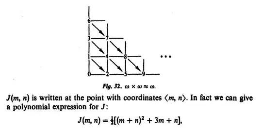

Assume $f$ is a function such: $$f: \omega\times\omega\to\omega$$ and $$f (\langle x,y\rangle) = \frac{1}{2}\left[(x+y)^2+3x+y\right].$$ How do I prove that this function is one-to-one (injective) an also from $\omega\times\omega$ onto $\omega$ (surjective)?
In Elements of Set Theory by Herbert B. Enderton, there's an image of such one-to-one function that is also from $\omega\times\omega$ onto $\omega$.
Actually I don't now how to verify that this function is a one-to-one correspondence.

Using the picture
It is clear that the function shown in the picture is bijective. So, if we can show that $f$ is the function shown in the picture, we will be done.
First, we observe that the function shown in the picture is $\langle x,y \rangle \mapsto T_{x+y} + (x+1) - 1$, where $T_n$ denotes the $n$th triangular number. This is true because the points enumerated by $f(\langle 0, 0 \rangle), f(\langle 0, 1 \rangle) , f(\langle 1, 0 \rangle), f(\langle 0, 2 \rangle) \dots, f(\langle x,y \rangle)$ form a triangle of side length $x+y$ plus a row of length $x+1$ and because the enumeration starts at $0$.
There is a nice formula for the triangular numbers that can be obtained by induction. Once you have obtained this formula, you can use simple algebra to show that $f(\langle x,y \rangle) = T_{x+y+1} + (x+1) - 1$.
