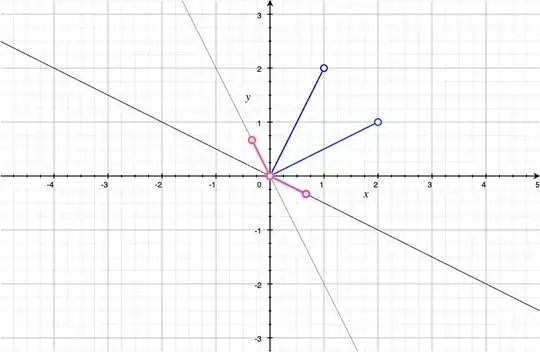

Suppose that we are given an invertible matrix ${\bf A} \in \Bbb R^{2 \times 2}$. Suppose further that there exists a matrix ${\bf B} \in \Bbb R^{2 \times 2}$ such that $\bf B^\top$ is the left-inverse of $\bf A$, i.e.,
$$ \color{magenta}{{\bf B}}^\top \color{blue}{{\bf A}} = \begin{bmatrix} \langle \color{magenta}{{\bf b}_1} , \color{blue}{{\bf a}_1} \rangle & \langle \color{magenta}{{\bf b}_1} , \color{blue}{{\bf a}_2} \rangle \\ \langle \color{magenta}{{\bf b}_2} , \color{blue}{{\bf a}_1} \rangle & \langle \color{magenta}{{\bf b}_2} , \color{blue}{{\bf a}_2} \rangle \end{bmatrix} = \begin{bmatrix} 1 & 0 \\ 0 & 1 \end{bmatrix} $$
where ${\bf a}_i$ and ${\bf b}_j$ denote the $i$-th column of $\bf A$ and the $j$-th column of $\bf B$, respectively. Note that ${\bf B}^\top = {\bf A}^{-1}$. Thus,
  • the 1st row of ${\bf A}^{-1}$ is orthogonal to the 2nd column of $\bf A$ and it forms an acute angle with the 1st column of $\bf A$
  • the 2nd row of ${\bf A}^{-1}$ is orthogonal to the 1st column of $\bf A$ and it forms an acute angle with the 2nd column of $\bf A$
Example
Let $ {\bf A} = \begin{bmatrix} 2 & 1\\ 1 & 2 \end{bmatrix} $, whose inverse is $ {\bf A}^{-1} = \frac13 \begin{bmatrix} 2 & -1 \\ -1 & 2 \end{bmatrix} $. Pictorially,
Note that
  • if the 1st column of $\bf A$ is dilated a bit, then the 1st row of $ {\bf A}^{-1} $ must contract to ensure that $\langle \color{magenta}{{\bf b}_1} , \color{blue}{{\bf a}_1} \rangle = 1$.
  • if the 1st column of $\bf A$ is slightly rotated, then the 2nd row of $ {\bf A}^{-1} $ must also be rotated to ensure that $\langle \color{magenta}{{\bf b}_2} , \color{blue}{{\bf a}_1} \rangle = 0$.

  • This is great :D
    How did you think this up? (what was the inspiration)? Was it in a textbook?
    – Ally Jun 11 '23 at 21:15
  • @Ally No textbook. If one is acquainted with Gram matrices or orthogonal matrices, this is all obvious. No deep insight here. – Rodrigo de Azevedo Jun 12 '23 at 07:57
  • How do you know that acute angles are formed? I understand the orthogonal part since there is the "if and only iff" aspect of zero dot product and angle between the vectors, but how does dot product equaling $1$ indicate acute angles? (My first thought would be that the vectors would be parallel and so the angle is zero in that case?) – Ally Jun 16 '23 at 01:27
  • @Ally The angles are acute because $1 > 0$. Thus, from two choices of direction, the correct direction is fixed. All that is left to determine is the magnitude – Rodrigo de Azevedo Jun 16 '23 at 05:49
    Okay, I suppose it's just that a positive dot product means an acute angle between the two vectors. And for your point about one's dilation and the other's contraction, that's basically, "if one is expands then the other contracts so that the dot product remains $1$". Either way, I think I've got this now and so I'll give you the bounty :D – Ally Jun 16 '23 at 22:57
