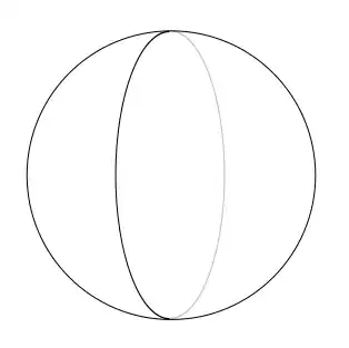

So far for the description. But what does it mean? To see that, we go to one dimension less and consider the sphere $S^2$, embedded in $\mathbb R^3$. Now consider the parallel projection when looking for example from positive $z$ direction (that is, from above). This projection means basically removing the $z$ coordinate. The image of the sphere is, of course, the unit disk. Now if a point on the sphere has a positive $z$ value, we can see it from above, otherwise we can't. It is customary to draw "unseen" lines on a sphere dashed in the projection. Another option is to use grey instead of black, which has the advantage that it also works for points. See the following image for an example (although you've probably already seen tons of such images):
Sphere parallel projection
This shows the disk (actually the circle which is the border of the disk), and the image of a great circle, where the front part ($z>0$) is drawn in black and the back part in grey. Now what this actually means is that there are two disks drawn on top of each other, where one disk is drawn in black, and the other in grey:
Sphere front Sphere back
The circle which forms the border of the disk of course only exists once, and only there we can get from one of the disks to the other.
