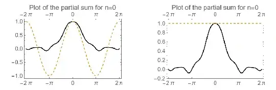

Conjecture. Let $f(x)=\dfrac{\sin(x\sin x)}{x^2}$. Then
$$ \sum_{k=-\infty}^{\infty} f(k\pi+x) = 1 \qquad\text{and}\qquad \sum_{k=-\infty}^{\infty} (-1)^k f(k\pi + x) = \cos x. $$
Unfortunately, I have absolutely no idea how to tackle this problems. The only evidence I have for this one is a numerical simulation:
Numerical comparison
(Figure. Left: A comparison between the partial sum $\sum_{|k|\leq n} (-1)^k f(k\pi + x)$ and $\cos x$ / Right: A comparison between the partial sum $\sum_{|k|\leq n} f(k\pi + x)$ and $1$)
If the conjecture turns out to be true, then we can prove some fun identities, including the original posting that motivated this question. For example, we obtain the following identity as a by-product:
$$ \int_{-\infty}^{\infty} \frac{\sin(x\sin x)}{x^2} \, \mathrm{d}x = \int_{0}^{\pi} \sum_{k=-\infty}^{\infty} f(k\pi + x) \, \mathrm{d}x = \int_{0}^{\pi} \mathrm{d}x = \pi $$
