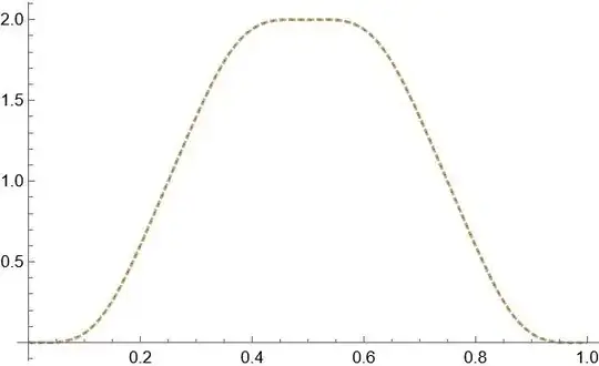

These doubt rises in this other question's answers by @Artes from where I am taking the following plot of $F'(x)$:

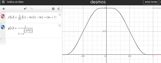

Even if I plot a polynomial approximation of $F(x+1)$ obtained as is shown in this answer (considering $m=3$) with function that do have a flat top like $g(x)=\left(1+\exp\left(\frac{1-2|x|}{x^2-|x|}\right)\right)^{-1}$ as you could see here is hard to believe it is not a flat function.

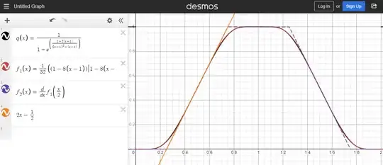

Since I cannot plot exactly the Fabius function, if I compare it with a polynomial approximation (as shown here for $m=3$) which should look analytical as is polynomial, but also with another approximation: $$q(x) = \left(1+\exp\left(\frac{1-2|x-1|}{(x-1)^2-|x-1|}\right)\right)^{-1}$$ which has flat top but it don't have a "straight-line slope" near $x=\frac12$ (also fulfill $F(0)=q(0^+)=0$, $F(1)=q(1)=1$, and $F(1/2)=q(1/2)=1/2$), so I could think as the real Fabius function being something "close" to both of them.
Seeing them plotted against $T(x)$ make hard to believe it is not analytical at $x = 1/2$ since the straight line is quite a good approximation to both functions (and the fact it have a defined Taylor series at $x=\frac12$):

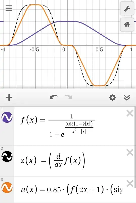

Then, by playing with $q(x)$ I realized two interesting things about the function: $$q(x,a)=\frac{1}{1+\exp\left(\frac{a(1-2|x|)}{x^2-|x|}\right)}$$
- The function $q(x,4)$ fits "really good" the function $r(x)$ if I change the definition of $f(x)$ to $$f(x)=\begin{cases}e^{-\frac{1}{x^2}},\quad x>0\\ 0,\quad x\leq 0\end{cases}$$
- The function $q(x,\frac{\sqrt{3}}{2})$ "looks like" a perfect smooth transition function with straight-line edges, fulfilling having a derivative with flat tops - but unfortunately it don't fulfill solving a DDE like $y'(x)=k\left(y(2x+1)-y(2x-1)\right)$ for some constant $k$.
You could see them on Desmos:
