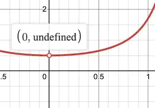

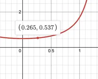

Desmos is actually pretty smart when it comes to functions with holes in their domain: it can visually distinguish between "points" and "holes" on the graph of a function. To see this, try clicking and holding on a point on the graph of your function. You should see something like this:
Now drag the point to the left, and see what happens when you reach $x = 0$:
Do you see how the point style changes from a solid circle to an open one, and the point label changes to indicate that the function is undefined there?

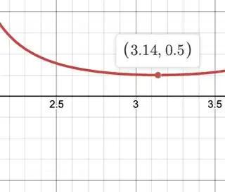

Now let's see what happens when you click and drag near $x = \pi$:
Why isn't Desmos displaying this "hole" as an open circle? It's because we can't drag the point exactly onto the point where the $x$-coordinate is $\pi$. Desmos is describing the point using a decimal approximation, and the best we can do is get close to $\pi$.

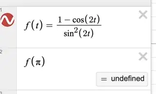

However, you can confirm that Desmos does actually know that the function is undefined there by explicitly asking (in the Algebra pane) for an evaluation of $f(\pi)$:

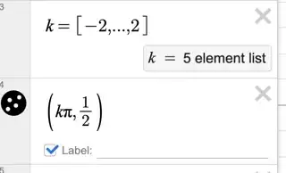

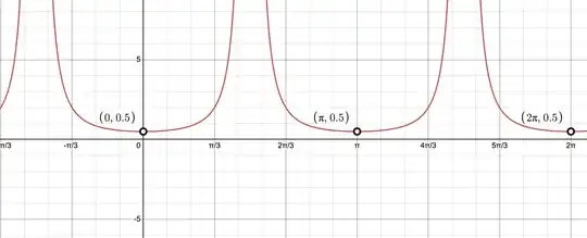

Once you know that there are supposed to be holes in the graph of the function whenever $x$ is a multiple of $\pi$, you can manually add them to the graph by plotting a sequence of points and setting the point style to be an open circle:
amends the graph as follows (only a portion is shown below):
