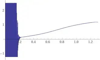

converges for about $0.4<|z|<1.3$. If $n\gg m$, the region of convergence is a bit larger, but not the original $0<|z|<1.3$:
