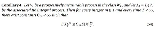

This falls into studying multiple iterated Wiener integrals (see Wiener chaos). Here one can at least get an upper bound. As mentioned in "Notes on the Itô Calculus" by Steven P. Lalley
and so for $m=2$ we get
$$E\left(\int f dW\right)^{4}\leq c_{2}E\left[\left(\int f^{2} dW\right)^{2}\right]^{2}=c_{2}\left(\int Ef^{2} ds\right)^{2}.$$
In case the link dies, the proof simply uses that Hermite polynomials $H_{2m}(x,t)$ of Itô integrals are martingales and that the leading coefficient is $x^{2m}$.
