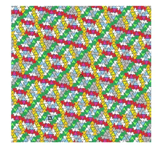

For your question 2: I think there are fundamentally different patterns. E.g. one with 3-fold symmetry, as shown here.
tiling with 3-fold symmetry
Similarly to Fig. 2.2 of the original paper, I have colored the chains of “stacked” hats similarly, which allows to see the structures quite clearly.
Certain ones of the “triangles” and/or “parallelograms” of different sizes can function as metatiles here to define this tiling recursively. (I think one should only consider those which are entirely delimited by 3 chains, without interruptions.)
I have noticed that there are parts of a certain size with a central symmetry, e.g. around the black square mark next to the lower left corner. The recursive definition should imply that in this tiling, there are parts with central symmetry of arbitrary size — but at this point, this is no more than a conjecture. (And of course, it should be easy to build a different tiling which has central symmetry altogether. Likewise, a still different tiling with 3-fold symmetry around a “triangle” of six gray hats, like the one just to the right of the black square mark.)

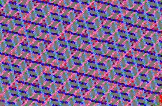

The fact that there are parts with central symmetry of arbitrary size should also hold for the pattern built with the “default” substitution rules as shown below. Note the slightly descending blue/black line of infinite length in both directions.
“default” construction It would be interesting to find out whether the percentage of (complete) “triangles” and “parallelograms” of a given size is the same for both tilings. A priori, it seems smaller in the tiling with 3-fold symmetry than in this one...
