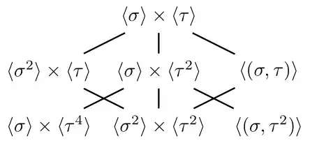

We have the following subgroup lattice of the Galois group, including only subgroups of index $1,2,4$:
Subgroup lattice

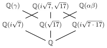

Subfield lattice of $\mathbb{Q}(\zeta_{2023})$, including only subfields with degree $1,2,4$:
Subfield lattice
As a sidenote, apparently $\beta=\sqrt{\frac{17-\sqrt{17}}{2}}$.
