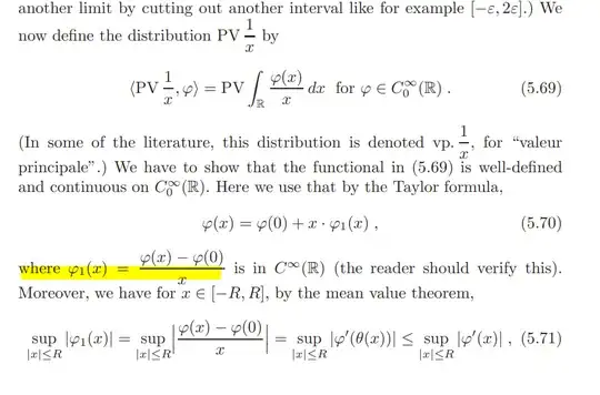

This is from the text "Distributions and Operators" by Gerb Grubb where the passage is taken from the section about the Cauchy Principal value:
The text claims $\varphi_1(x)$ is smooth but I'm having some problem seeing this. May I ask how it is shown that we have continuity and smoothness at $x=0$?

Continuity at 0 can be seen, for instance, from L'Hospital's rule and $\varphi_1(0)=\varphi'(0)$. As for differentiability, notice that $$ \varphi_1'(0):= \lim_{x\to 0} \dfrac{\varphi_1(x)-\varphi_1(0)}{x}= \lim_{x\to0} \dfrac{\varphi(x)-\varphi(0)-x\varphi'(0)}{x^2}, $$ and L'Hospital's applied twice (or Taylor approximation) give that $\varphi_1'(0)=\varphi''(0)/2$. From here, you can do an induction argument and use Taylor's theorem/L'Hospital's rule.
