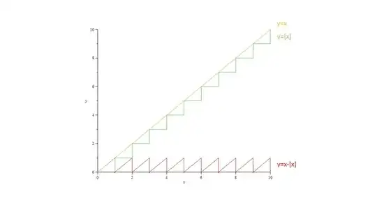

I wondered if a similar 'bottom up' formula exists, i.e. involving the infinite sums of (complex) zeros (call them $\mu$) of a function. Such formula would then look like: $n(x) = x - c - \sum_{\mu} \dfrac{x^{\mu}}{\mu}$. At the integers it obviously needs to be zero, but between the integers it needs to sum up an infinite amount of sine waves that then culminates into the saw tooth pattern in the graph below. enter image description here

The formula for the sawtooth wave in the graph above is easy to derive and is:
$$\displaystyle saw(x):=\frac12 - \frac{1}{\pi} \sum_{n=1}^{\infty} \frac{\sin(2nx\pi)}{n}= \frac12 +\frac{i}{2\pi}\ln(e^{-2\pi i (x-\frac12)})$$
However, this does not yet allow me to express $n(x)$ into an infinite sum involving (complex) zeros.

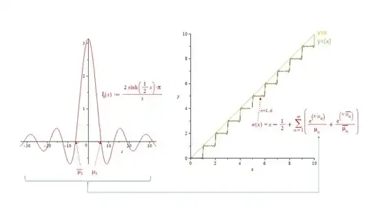

Here is a graphical illustration ($s$ is a complex number in the left graph):
The result can generalized for all (also non-integer) multiples. Let $l \in \mathbb{R}$ and assume $l=1 \rightarrow x=1,2,3...$, $l=2 \rightarrow x=2,4,6...$, $l=\sqrt{3} \rightarrow x=\sqrt{3},2\sqrt{3},3\sqrt{3}...$,etc. Then the generic multiple counting function becomes:
$$\displaystyle n(x,l):= \frac{x}{l}-\frac12 + \sum_{n=1}^{\infty} \left(\frac{e^{\dfrac{x \mu_n}{l}}} {\mu_n}+\frac{e^{\dfrac{x \overline{\mu_n}}{l}}} {\overline{\mu_n}}\right)$$
where $\mu_n$ and $\overline{\mu_n}$ are the n-th pair of complex roots of:
$$\displaystyle \xi_{int}(s,l) = \frac{ 2 \pi \sinh \left(\dfrac{ls}{2}\right) }{s}$$
For completeness' sake I also list the closed form for this counting function:
$$\displaystyle n(x,l):= \frac{x}{l}-\frac12 - \frac{i}{2 \pi} \ln \left(e^{-2\pi i(\frac{x}{l}-\frac12)} \right)$$
Now the only remaining question is where the constant $\frac12$ originates from. Tried already $\dfrac{\xi_{int}'(0)}{\xi_{int}(0)}$, similar to the prime counting function, but no success yet.
