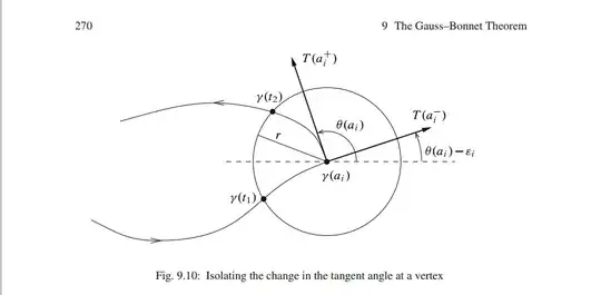

C.f. For a supplement, let's look at the next image :
Such a ball of radius $r$ exists?

  • And can I ask a further interlude question? In proof of the Theorem 9.1 of the Lee's Riemannian manifolds, eleventh paragraph, he continues to argue as follows :"Let $t_1 \in (a_i-\delta ,a_i)$ denote a time when $\gamma$ enters $\bar{B_r}(\gamma(a_i))$, and $t_2 \in (a_i , a_i +\delta)$ a time when it leaves (C.f. Fig. 9.10 in my question)." Why such $t_1$, $t_2$ exists? – Plantation Apr 30 '23 at 04:56
    $\gamma^{-1}(\bar{B}_r)$ is a closed subset of $(a_i-\delta, a_i+\delta)$, hence it has an infimum (as do all sets which are bounded below). This is your $t_1$. It is necessarily in the set by closure. – Ben Ciotti May 01 '23 at 21:57
  • For the final sentence in your comment, you mean $t_1 \in (a_i - \delta , a_i)$? Anyway, I somewhat understand. Thanks. – Plantation May 02 '23 at 02:40
    More to the point, $t_1 \in \gamma^{-1}(\bar{B}_r) \subset (a_i-\delta, a_i+\delta)$. Actually though it might be a better idea to define $t_1$ as the supremum over $t<a_i$ of $\gamma^{-1}(\partial B_r)$. That way it is the last time the path enters $B_r$. Alternately you could define $(t_1, t_2)$ as the largest interval containing $a_i$ whose image under $\gamma$ is in $B_r$. – Ben Ciotti May 02 '23 at 04:05
