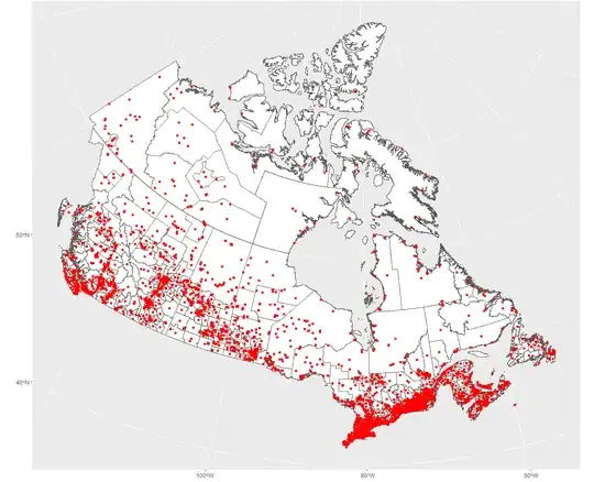

The results look something like this:
CENTROID
As we can see, some of these polygons appear to have multiple centroids ("red points") - this means the centroids for some of these polygons are located outside of these polygons themselves!

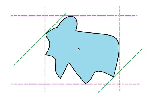

Consider this Blue Polygon (more generally : Shape/area/region) with Centeroid @ $O$ :
LIGHT BLUE POLYGON
Then , $C_x$ , the x-Co-ordinate of $O$ , must be within the Gray lines.
More-over , $C_y$ , the y-Co-ordinate of $O$ , must be within the Purple lines.
In general , we can have Slanting Parallel lines (Eg the Green lines) touching the Polygon at the 2 Extremes , where we can say that $O$ & $C_x$ & $C_y$ must lie within those (Green) lines.
Thus , the Centeroid must lie within the "Zone".
Proving that is via Symmetry , Integration , linear Combinations , Etc.
(2) Must the Centeroid be a Part of the Polygon ? Not necessary ! It must be in the "Zone" but not necessarily within the Polygon !

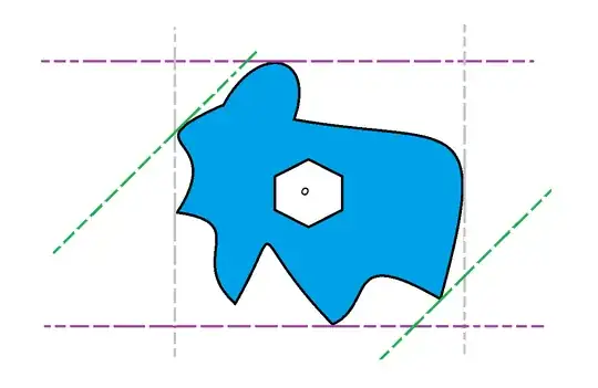

Example 2.1:
Take the Earlier Image , Cut out a Part which has $O$ , then the Centeroid may move around a little , but it will be "outside" the area , though within the "Zone" !
DARK BLUE POLYGON
Here , I have Cut out a Small Hexagonal area , hence $O$ will lie "outside" the Blue area , maybe moving around a little.

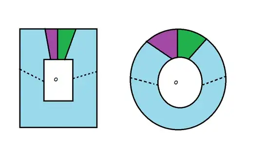

Example 2.2:
Consider Squares & Circles , where the Centeroid is at the Exact "Center".
Square Circle
We can cut out a smaller similar area at the Center , then the Centroid is outside , though still at the "Center". We can then cut out the Purple Part , which will make the top lighter , the bottom heavier , hence $C_y$ will move downward. It makes the left lighter, the right heavier , hence $C_x$ will move a little right.
We can then cut out the Green Part , which make the top lighter , hence $C_y$ moves downwards. It makes the left & right Equal weight , hence $C_x$ goes back.
With a large enough cut-out (Eg at the Dotted lines) , we can make the Centroid move downward back into the Blue area.
