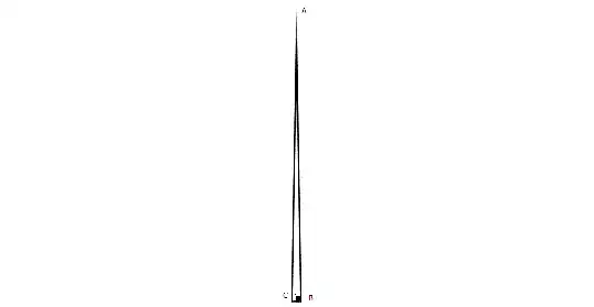

Figure: Sharp right triangle.
$\angle B=\angle C=90^\circ$, $CB=a$, $AC=\infty$: $$\cos\angle C=\frac{CB}{AC}=\frac a\infty=0.$$
