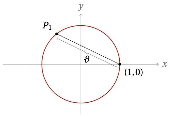

Basically, one first create a chord of length $0 \leqslant \theta \leqslant 2$ starting from the origin point $(1,0)$ to a point $P_1$ on the unit circle.

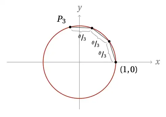

Now, if you divide the length $\theta$ by a given constant $n$ and create a sequence of multiple tail-to-tip chords, then you have $n$ points on the unit circle from $P_1$ to $P_n$ and the total length [of all chords] remains $\theta$.
You want to find the couple $(x_n,y_n)$ by solving the tail-to-tip recurrence system given by
$$ \begin{cases} (x_k - x_{k-1})^2 + (y_k - y_{k-1})^2 = \left(\frac\theta n\right)^2 \\ (x_k)^2 + (x_k)^2 = 1 \end{cases} $$

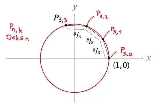

But as for the method: For the case with n chords, denote the points by $P_{n,k}\, $, $0 \leq k \leq n$, and $P_{n,0} = (1,0)^t$. enter image description here Your formula for P1 holds in any case for $P_{n,1}$ with $\theta$ replaced by $\theta / n$:
$P_{n,1} = \begin{bmatrix} 1 - (\frac \theta n)^2 / 2 \\ \frac\theta n \cdot \sqrt{1-(\frac \theta n)^2 / 4} \, \end{bmatrix}$
You know, that this is ($\cos(\phi) , \sin(\phi)$) for some angle $phi$ related to $\theta$.
Whith these entries, build the matrix which provides rotation about the origin through that angle $\phi$, but take $\frac\theta n$ as the argument:
$ R(\frac \theta n) = \begin{bmatrix}1-(\frac \theta n)^2/2 & -\frac\theta n \cdot \sqrt{1-(\frac \theta n)^2 / 4} \\ \frac\theta n \cdot \sqrt{1-(\frac \theta n)^2 / 4} & 1-(\frac \theta n)^2/2 \end{bmatrix}$
The first column is the coordinates of the point $P_{n,1}$ which is $(1,0)$ rotated through $\phi$. The second column is $(0,1)$ rotated through $\phi$, so it makes a right angle at the origin with $P_{n,1}$.
By using the rotation matrix, the coordinates of the points are obtained as
$P_{n,k} = R(\frac \theta n)^k \begin{bmatrix}1\\0\end{bmatrix}$
Now, compute $R(\frac \theta n)^n$ and prove the formula by induction over n. (Your formula has misprints, I guess.)
