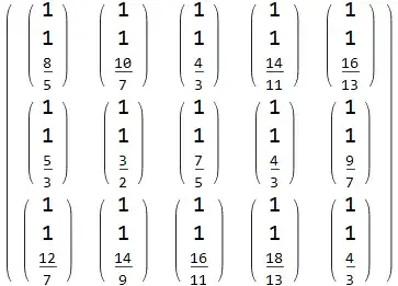

To illustrate that this really works we Took $N=2,3,4$ and $T=2 \zeta+1+N$ for $\zeta=1,\cdots,5$ and for each value of $(N,T)$ we compute the first three spectral moments, i.e. $p=0,1,2$, using the last equation in $(5)$. The results are given below where the rows & the columns are labelled by $N$ and by $T$ respectively. Here we go:
mGamma[NN_, x_] :=
  Pi^(NN (NN - 1)/4) Product[Gamma[(2 x - j)/2], {j, 0, NN - 1}];
Pfct[NN_, T_] :=
 Pi^(NN^2/2) 2^(-NN T/2)/(mGamma[NN, NN/2] mGamma[NN, T/2])
Table[With[{T = 2 Zeta + 1 + NN}, Abs[Pfct[NN, T]/(NN T^P) Sum[(D[ ll[[NN - 1]] /. A[j_] :> Sum[A[xi], {xi, 1, j}], Evaluate[ Sequence @@ Table[{A[xi], Zeta + If[xi == j, P, 0]}, {xi, 1, NN}]]] /. A[eta_] :> 1/2), {j, 1, NN}]]], {NN, 2, 4}, {Zeta, 1, 5}, {P, 0, 2}] // MatrixForm
