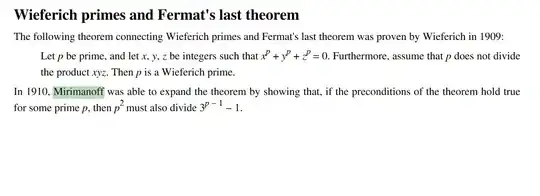

Addition If $p>3$ is a prime number and divides $T_n$, then $p=1+k2^{n+1}$ for some $k\in \mathbb N$. If we assume that $p^2$ divides $T_n$, then $3^{2^n}\equiv -1 \mod p^2$, and with this integer $k$ ($k=\frac{p-1}{2^{n+1}}$), we have $3^{k2^{n+1}}=(3^{2^n})^{2k}\equiv 1 \mod p^2$. Thus, $3^{p-1}\equiv 1 \mod p^2$, which implies that $p^2$ divides $3^{p-1}-1$. But i dont see how to use thisenter image description here

  • I saw you asked a related question on MO, does that question helps answer this one? I believe it disproves your conjecture here but only if provided that one of the prime divisors of the Fermat number is also Wieferich prime so you still need to know if that could in fact happen but maybe I understood wrong and more (less?) is being proved – Dabed Apr 21 '23 at 23:46
    @Dabed I can also prove that a prime divisor $p$ of $T_n$ is a Wieferich prime if and only if $p^2$ divides $T_n$. The difficulty is that I have no way to prove the conjecture and it's also difficult to provide a counterexample because if $p|T_n$ and $p^2|T_n$, as above, then $p$ is a Wieferich prime, but only two numbers of this type are known at the moment. In summary, we cannot prove or disprove the conjecture. – Paul Apr 22 '23 at 00:26
