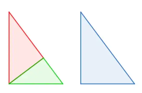

One way to prove the Pythagorean Theorem is by noticing that its altitude divides it into two pieces similar to itself. The theorem immediately follows from the fact that areas scale with the square of the ratio and the ratios are determined by the sides of the big triangle.
The thing about this proof is that it doesn't seem to have anything to do with triangles. Wouldn't any family of shapes that can be - non- trivially - divided into similar copies of itself yield a similar result?

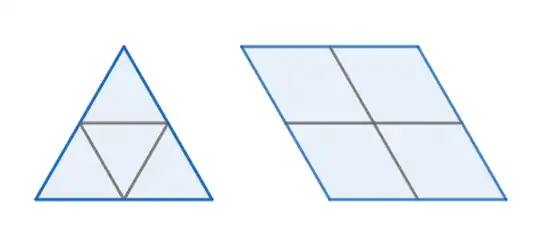

The condition for a non-trivial division is inspired by the fact that any triangle or parallelogram can be divided into four congruent copies of itself, but this division doesn't lead to any interesting equation.

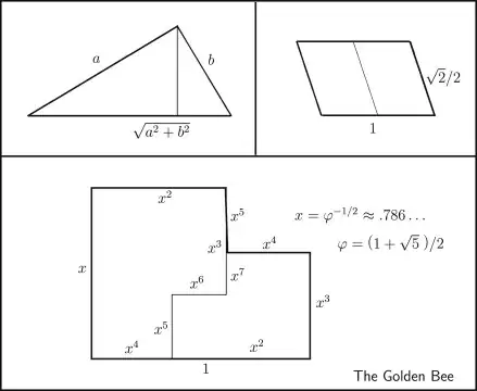

Update 1: I just came across this article, which surprisingly proves that any polygon that can be divided into two similar copies of itself must be similar to one of the following:
As the parallelogram, the Golden Bee do not give us any equation. This already implies that the Pythagorean Theorem is, if not the only one, the simpler of its kind.

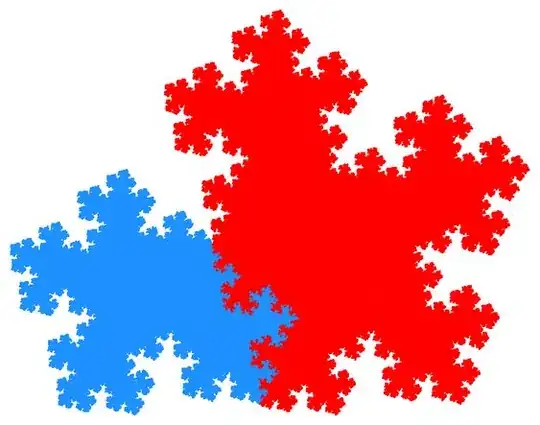

But that is not taking fractals into account:

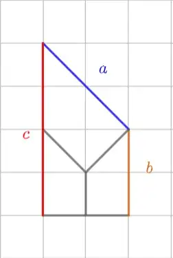

That being said, the following shape called my attention:
This one leads to the equation $a^2+2b^2 = c^2$. However, this seems to be, again, a rigid shape, so we can't really choose $a$ and $b$.
