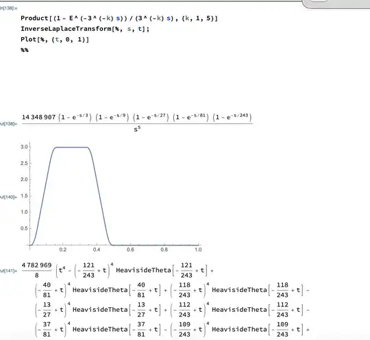

The pdf of the distribution you seek is a spline polynomial of degree $n-1$ that has $2^n$ nodes. However,your distribution actually stabilizes quickly with just a few values of $n$. Here is picture of an example of the distribution, with $p=1/3$ and $n=5$ convolutional layers. You get essentially the same picture with just $n=3$ layers. The reason? When you adjoin more layers of complexity you are convolving the prior probability distributions with rectangular window functions that have very narrow widths and are essentially delta functions.
Note. Modifying the observation in Snoop's comment, I used the convention $R=[0,1]$ rather than $ R=[-1,1]$ ( so that I could use a built-in Laplace transform inverter rather than the Fourier transform). This translation of the center of the interval merely has the effect of re-centering the distribution you seek.
See this related post for additional info regarding sums of uniformly distributed random variables that live on different intervals. sums of uniform random variables with different support intervals
