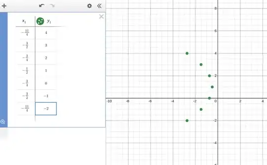

plotting points: which is what they asked
$$ x = - \left( \frac{(y-1)^2 +2}{4} \right) $$
