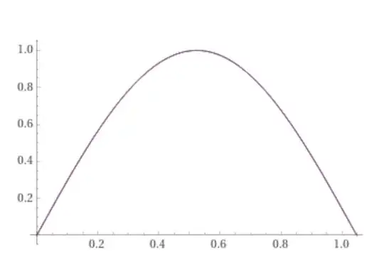

$\sin(3 h_1((g_1(x)))=\sin(3x)$ plot where $e^{-\sqrt3\pi}-e^{-\frac{4\pi}{\sqrt3}}+2\approx 2.00362$ for $n=10$:
The series gives $h_1\left(1+e^{-\sqrt3\pi}\right)\approx 0.524$ and $x_1=\frac2{\sqrt3}\left(h_1\left(1+e^{-\sqrt3\pi}\right)+\pi\right)\approx 4.233$ correctly.
