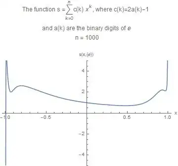

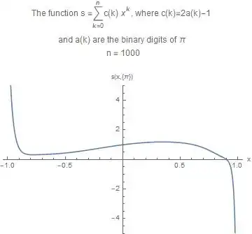

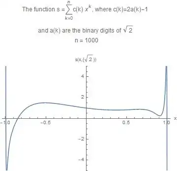

Let us take the a non periodic function following the non-perodicity of a irrational number $z$.
Let $a_0, a_1, a_2, ...$ the binary representation of the number $z$.
Since we have $a_i \in [0,1]$, $c_i=2 a_i-1$ is a non-periodic sign function.
We now plot the sum $s$ as a function of $x$ for some famous irrational numbers
The emerging divergence at $|x| \to 1$ is manifest in all three cases.
This hints strongly towards a divergence of the sum for any distrubution of the signs when $|x| \to 1$.
In other words, the sum for abitrary $c_k$ converges only if $|x| \lt 1$.
