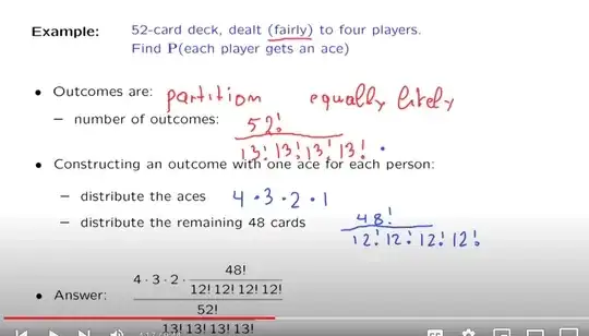

This probably sounds like a really stupid obvious question, but bear with me. I have attached the problem from a lecture from MIT Intro to Probability course. I simply do not understand why multiplying the number of ways to distribute 4 aces by the number of ways to partition the remaining cards is necessary. Can't you just multiply 4C1 with 48C12?

To stretch your intuition, consider the situation player by player, starting with the first player to receive cards, Player-1. Assume, without loss of generality, that he is given the first $~13~$ cards off of the top of the deck, and further assume that exactly $~1~$ of these $~13~$ cards is an Ace. How many different card combinations are possible. $$\text{Answer}: ~~\binom{4}{1} \times \binom{48}{12}.$$ Before going any further, does the above computation agree with your intuition? If not, please explain. If so, then what about Player-2? – user2661923 Mar 23 '23 at 23:13
Write it as $\dfrac{\dbinom{4}{1,1,1,1}\dbinom{48}{12,12,12,12}}{\dbinom{52}{13,13,13,13}}$ – true blue anil Mar 24 '23 at 04:57
@user2661923 Yes, this does agree w/my intuition...I think I understand it now. I was just forgetting some fundamentals and what the multinomial coefficients represents. I understand we need to multiplythe number of ways you can distribute 4 aces with the number of ways to partition the remaining cards. But I'm a bit confused as to how we get from what you provided to the final answer. – Mar 24 '23 at 19:30
So, does the last comment of true blue anil, directly above, now make sense? Do you now understand and agree with the formula presented in your posting? – user2661923 Mar 24 '23 at 19:32
@user2661923 I do understand it, yes, thank you for your help. – Mar 24 '23 at 19:45
