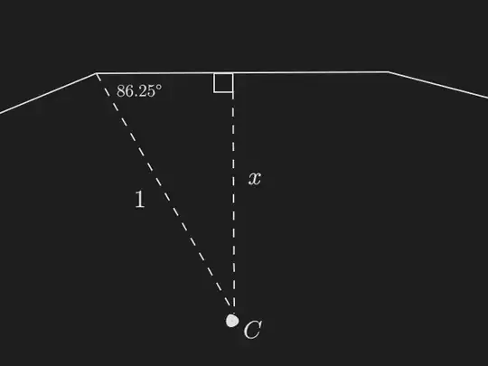

First, we find the elements of set $X$ - the distances from the centre of the circle to each side of the $48$-gon. Let $x$ be the distance from the centre of the circle to one side of the polygon.
We draw this diagram (not to scale) and find out the following values.
A right-angled triangle, starting from the centre of the polygon, C, with its hypotenuse being the radius of the circle that the polygon is inscribed in.
A line from the centre of the $48$-gon, $C$, to one of its vertex is equivalent to the radius of the circle, which is $1$. This is the hypotenuse of the right-angled triangle.
That line is also an angle bisector of one of its interior angles. Each interior angle of the $48$-gon is $\frac{180°(48-2)}{48}=172.5°$, so $\frac{172.5°}{2}=86.25°$.
Now, we find that $x = \frac{\sin(86.25°)}{1} = \sin(\frac{23\pi}{48})$ in terms of radians.
As such, there are $48$ elements in set $X$, each element with the value of $\sin(\frac{23\pi}{48})$.
