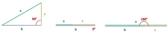

The quantity $2bc⋅\cos(\theta)$ can be considered as a correction factor which covers all the possible cases, for example:
$\theta = 90° \implies \cos(\theta)=0$ which is indeed the Pythagorean theorem $a^2=b^2+c^2$
$\theta = 0° \implies \cos(\theta)=1$ which is $a^2=b^2+c^2-2bc =(b-c)^2$ and indeed $|a|=|b-c|$
$\theta = 180° \implies \cos(\theta)=-1$ which is $a^2=b^2+c^2+2bc =(b+c)^2$ and indeed $a=b+c$
