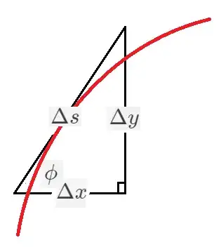

Just before a differential disappears in the limit we are allowed to view them as small segments of length or small packets of velocity. Even after disappearance their ratio continues to make sense.
$$ \frac{\Delta y}{\Delta x} \to\frac{dy}{dx} =y' = \tan \phi$$ $$ \frac{\Delta x}{\Delta s} \to\frac{dx}{ds} =\cos \phi$$ $$ \frac{\Delta y}{\Delta s} \to\frac{dy}{ds} =\sin \phi. $$
Similarly packets of mass or velocity in a packet (interval) of time made.. even now makes sense in the Newtonian formulation of force :
$$ F =\frac{\Delta(m v)}{\Delta t }= \frac{v\Delta m}{\Delta t }+\frac{m\Delta v}{\Delta t }$$
$$\to v\frac{dm}{dt }+m \frac{ dv}{dt } $$
Even after the disappearance of finite differential form their product continues to make sense.
