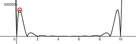

Here is the graph for $n=10$.
The turning point in $x\in(0,1)$ on $y=\color{red}{\frac{\log{n}}{n!}}|x(x-1)(x-2)\dots(x-n)|$ has the following approximate coordinates:
$n=10: (0.2854, 0.2644)$
$n=20: (0.2450, 0.2877)$
$n=40: (0.2131, 0.3031)$
$n=80: (0.1879, 0.3137)$
$n=160: (0.1675, 0.3215)$
I'm guessing the asymptotic expressions will be something like $\left(\frac{1}{\log{n}},\frac{n!}{k\log{n}}\right)$ for some constant $k$.
