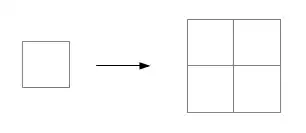

First of all, if $V$ is a vector space, and we are in $ZFC$ it has bases and all bases have same amount of elements, let's say $n$. Then, we define dimension of this vector space $V$ as $n$.
Secondly, let's approach with measurement. If we have a line, double it and we have $2$ line. If we have a rectangle, double it, and we have $4$ rectangle. You can visualize this with the picture bellow. So, we can say, an object is $n$ dimensional if, let's say we will have $m$ of it when we double it, $log_2m = n$. We can think about this fractal. If we do this fractal and double it, we will have $3$ copy of it. So, it's dimension is $log_23 (= 1.585...)$. Also, instead of doubling one can multiply the measures of object by $k$ and dimension will be $log_km$ with same definition of $m$.
