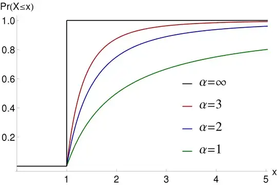

Here is a visualization of the corresponding cumulative density function for various $\alpha$, with $x_m = 1$.
The Pareto distribution.
For instance, suppose that 20% of landowners in an area own 80% of the land. I don't understand which part of the distribution corresponds to landowners and which part corresponds to land.

In your picture the values along the horizontal axis represent the amount of land owned by a randomly selected individual. The curve being plotted for a given $\alpha$ is a cumulative distribution function for amount of land owned, so the value of the curve at $x=t$ gives the fraction of individuals who own at most $t$ units of land.
If you are looking for the landowners who own 80% of the land, this is understood to mean those folks at the upper end of the wealth distribution. So you seek a threshold $t$ such that the total land owned by those who own $t$ or more units is $.8$ of the total land owned by everybody.
Notice that total land is not visible in the picture; to get total land you have to start with a histogram of land owned, and multiply each amount of land by the number of people who own that amount of land, then sum up. This total can also be computed using a density function, as described below.
