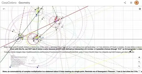

I went ahead and constructed everything in Geogebra https://www.geogebra.org/m/twce3tar (using Euclid's https://en.wikipedia.org/wiki/Compass_equivalence_theorem 5 times to construct all the similar triangles I needed). Below is a screenshot: the dark green $A$ and dark red $B$ can be moved by the user, as well as the points $C,N$ on the real line marked by a big X symbol. The statement of commutativity then becomes that the following observation: the 2 dark red dashed-dotted lines meet at the point $A\cdot B$ (multiplication action from $A$ scaling the plane, acting on $B$), and the green dark dashed-dotted line meets those 2 dark red dashed-dotted lines at the SAME point. I was hoping that constructing everything from scratch, it would help me see exactly how this concurrence occurs, but alas it just made the picture very muddled. commutative property of complex multiplication (almost looks like something out of CERN).
That this is a result about concurrence of 3 lines reminded me of Desargues's theorem which is known in some sense to "characterize planar geometry" (loosely speaking), but drawing out the axis of perspectivity (in the Geogebra as a bright yellow line in the lower half plane) didn't reveal anything to me.
