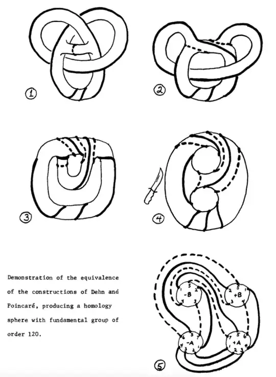

I know that past a certain point, one should graduate from the view that homology/homotopy groups "count holes" in any realistic, grounded, real-life meaning of the word "hole". However, I still want to see if there is any visual intuition to be had regarding the Poincare homology sphere, which is sort of the first example of Is there a non-simply-connected space with trivial first homology group? (also the first example in this MO thread).
I did come across https://ben300694.github.io/pdfs/2020/2020-01-29_Slides_Some_faces_of_the_Poincare_Homology_Sphere_(Bonn,_IMPRS_Seminar).pdf, which presents some nice but difficult (for me) to make-sense-of pictures enter image description here or another picture here https://mathoverflow.net/questions/353814/understanding-fundamental-group-of-poincare-homology-sphere.
