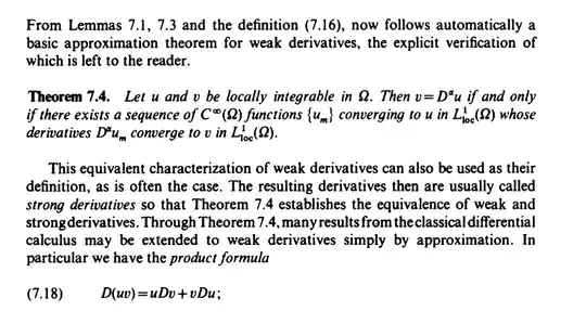

It appears the theorem is true (if my understanding is exact). Here is a pic of Gilbarg and Trudinger, Elliptic partial differential equations of second order, thm. 7.4
Gilbarg and Trudinger 7.4
