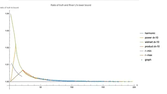

Suppose $h$ is a probability distribution over $d$ outcomes, and $\lambda(h)$ is the largest value of $\lambda_1$ satisfying the following inequality:
$$\frac{h_1}{\lambda_1 - 2h_1} + \frac{\sum_{i=2}^n h_i}{\lambda_1} + \frac{2\sum_{i=2}^n h_i^2}{\lambda_1^2} \ge 1. $$
Can we say anything about the value of $\lambda(h)$ when effective rank $R(h)=\frac{(\sum h_i)^2}{\sum h_i^2}$ is large?
Empirically, this value seems to approach $\|h\|_1 + 2 \|h\|_\infty$ as we increase $R$
This is a follow-up on earlier related question . Proving this would show that matrix $l_1$-norm and spectral radius coincide for high-dimensional diagonal+rank1 matrix $A=2\text{diag}(h)+h \otimes 1^T$
Notebook

  • Interesting! So it looks like in my graph things converge because $h<<\rho$, so I'm seeing 0'th effect of $r$ – Yaroslav Bulatov Feb 28 '23 at 01:42
  • Note that $h \ge \rho = \sum \mathbf{h}_i^2 \ge h^2,$ so $h \ll \rho$ doesn't happen. In any case, I think if $h \ll 1,$ then $\lambda$ is roughly $1$ because $1 + \rho \le \lambda \le 1 + 2h$ for $h < 1/2.$ – stochasticboy321 Feb 28 '23 at 03:03
  • Oh right, $\rho \lessapprox h\lessapprox \sqrt{\rho}$, more precise bounds are given in https://math.stackexchange.com/a/4635453/998 . So the "high-dimensional case" is where $h\approx \rho$, and both of them are <<1. It seems in this case $\lambda$ should approach 1 – Yaroslav Bulatov Feb 28 '23 at 20:32
